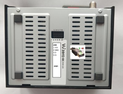

I used Zero4K PVR KIT socket as a second USB for Zero4K. Enjoy :)
Hello my friend. I want thank you so much because want so much use disk in my vu Zero4k but don't want pay lot of money for dock. So after check your post i make one USB adapter and connected my portable disk. This working amazing and only left one thing to be complete. This is only first test but working amazing
