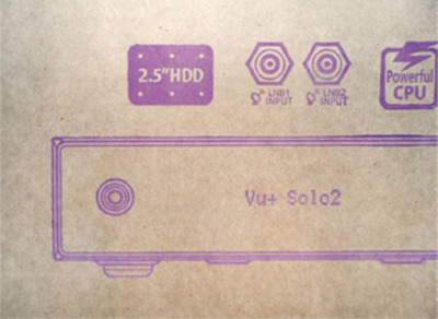

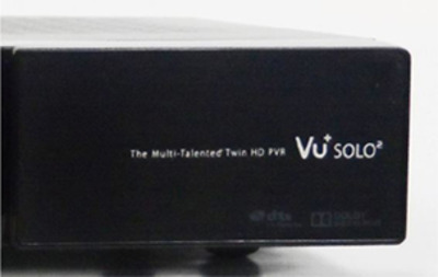

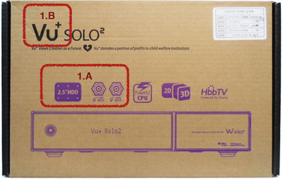

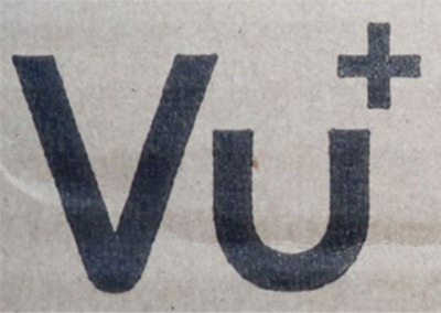

Guidelines to detect Solo2 clone box

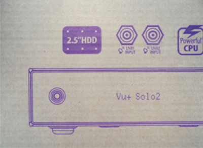

Outside the Box (Top)
By Checking the Color Difference
Original
Blue based VioletPink based Light Violet
Clone

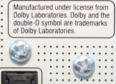

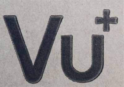

By Checking Quality Difference in the Printing
Original
Border of Printing is ClearBorder of Printing is Light and Not Sharp
Clone

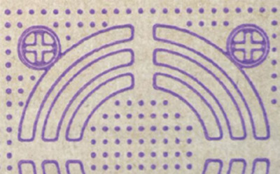

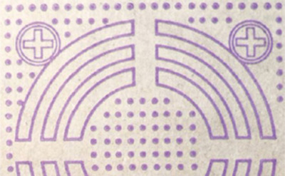

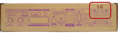

Outside the Box (Rear)
By Checking FAN Drawing in Rear
Original
Rounded EdgeEdged Shape
Clone

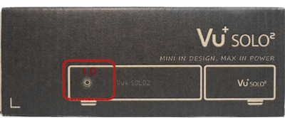

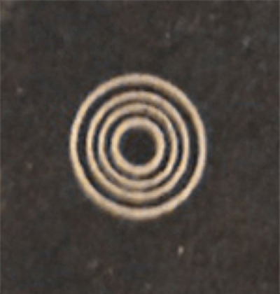

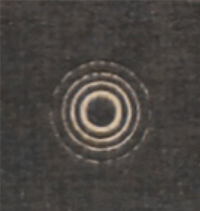

Outside the Box (Side)
By Checking Symbol on Sides
Original
Each Line is Getting Thinner InsideAll Lines Keep Same Thickness
Clone

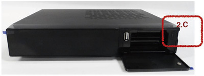

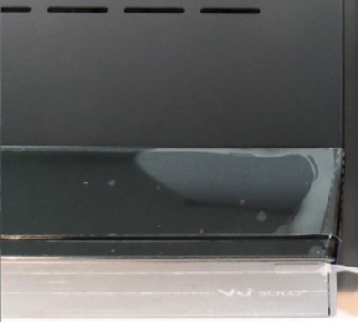

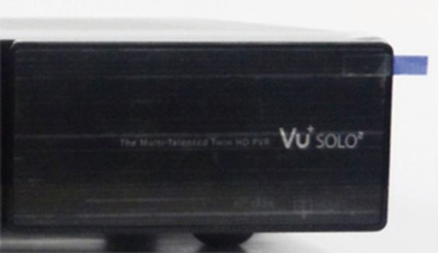

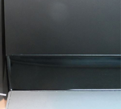

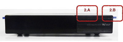

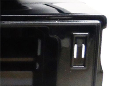

Inside the Box (Front)
By Checking Spray & Protect Vinyl
Original
High Glossy Resin Used. (No Spray)
Protect Vinyl Attached.High Glossy Spray.
Tiny Bubbles Found Also.
Clone

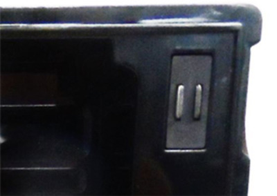

Original
Detacher Attached for Easy Handling of VinylNo Detacher Attached.
Clone
Original
With MagnetWithout Magnet
Clone

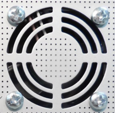

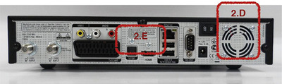

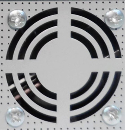

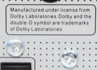

Inside the Box (Rear)
By Checking Dots Inside FAN (Venting Hole)
Original
Dots Inside FANNo Dots Inside FAN
Clone
Original
Clone
