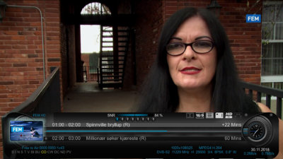

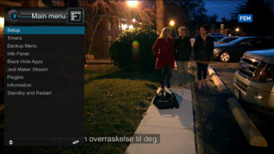

Hi i have some question about skinning for BlackHole Image. I skin for personal use so are using Matrix skin code as my baseline (Default skin MX_HQ10). I have done new graphics like infobars buttons and Borders.
My question is, When testing the skin it allways crash on the border grapichs is there some standard they
have to be? Like colors and transparence settings? I have try 256 websafe color with and without transparence, same with 16,7 million (24bit) but same problem. I don get any crashlog, no Blackscreen
just frozen bootlogo. When i remove them and put the original back everything is working with the skin.
If i run the same skin in OpenBlackhole everything is working just fine with the graphics. Of cause
since skin code is for Blackhole some panels are not showing right in OBH but all graphics are working.
Could some one maybe give me some basics knowledge graphicsto use with BlackHole skins?
Here are some screenshots from OBH 4.2
I got it working hade to copy my png in as new layer in to the original border png, then merg all visible layers and save.
So my 24bit png is not the problem there must be some limitation in BlackHole skinning that blocks custom made grapichs. I now you have some built in python code that blocks all skins not made by Matrix or Army
Maybe there are some more code that limits some of the grapichs also?

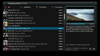

View attachment 40662 View attachment 40663

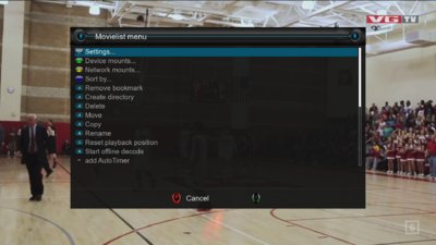

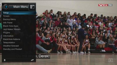

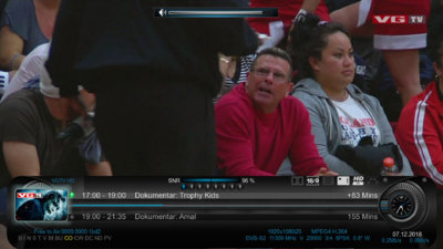

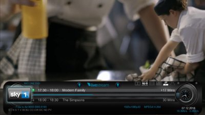

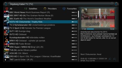

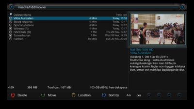

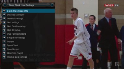

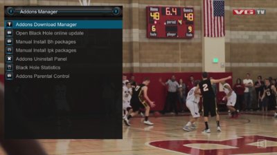

Here are some update to the skin graphics. Buttons selectbars and icons. I did borrow some icons from Army why invent the wheel when it allready been done and are perfect. I try to get hold of Army to get his approval but the guy
seems to visit the forum just a few times a year so just have to wait.
My first opinion was that skinning for OBH is easier and i still have that opinion. I like the include xml file you can do with OBH so for me who have converted several skins like "SlyQ, VirginSkin and Freesat" (with the approval from the skin authosr of cause) from ATV/VIX to OBH think this is nice
Why... well because i dont have to rewrite all panels just include the missing panels for Addons, Settings and Bluepanel. all other panels work just fine as they are since images are built on Open Alliance.
I also modded my OBH image so it have Infopanel from ATV, VixPanel from OpenVix. I added Nab_ExtraInfobar, Redpanel and SysInfo panel from Blackhole so i can check my skins without rebooting in to the other images
until the final testing then of cause all images must be tested separate. I also found out what the problem with Blackhole border graphic was :) Blackhole are as matrix explained much more strick when it comes to skincode. If graphic bs_t is just 1 pixel wrong in size it will crash so i hade to be more accurate when sizing.
So now all is working just fine in Blackhole also :) and in someway i might change my opinion... Because when a skin is working in Blackhole there is no small bugs or wrongs and i the end that is what we all want.
So in the future i will use Blackhole skincode as my baseline and build from that.
Still some workl left but i am getting there..
