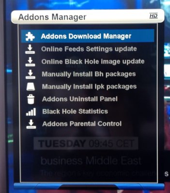

I have a vu plus which I bought 2 years ago. I need to install genesis and it said download from downloads manager. I m requested to enter pin. Can anyone send me the pin please.

Well you or someone else has activated PIN
The default PIN is 0000 but I think someone changed your PIN
or not .If not press OK
If you not like to have PIN disable in Addons Parental Control

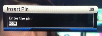

I know pin for parental control but it's not the same for this. I have tried 0000 but it does not work also. I disabled parental control but still I m required to enter pin

PIN is the same for both parental control and download.
Already tried with the most common combinations?
1111
2222
3333
etc...
1234
5678
etc...

Goto Menu>Setup>Software Management>Advanced>backup location>OK
Press OK on the desired location such as harddisk
Press Exit once only>System backup>OK
A file named enigma2settingsbackup.tar.gz is generated and should be found in media/hdd (or in your desired backup location)
Exit completely
Copy the tar.gz file to PC and extract it
Open folder and goto etc/enigma2/settings
Open the settings file with Notepad++
Your pin will be found on the line named config.bhaddons.pin=
Good luck
