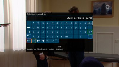

using OBH 4.2 on solo 4k I've a problem with virtual keyboard:
for example while seeing EPG, if I want to make a search pressing Yellow button "new Search", the virtual keyboard appears but is impossibile to interact with it and is impossible close it.
Only way to use VU again, is off/on on the back
I found out that the problem was not present in version release-4.2.001. Upgrading to version 4.2.025 the problem with virtual keyboard exist: not only using EPG but for example trying to rename imgIMG in OMB plugin. I noticed that the graphic of virtual keyboard is slightly different and now the name is "Tastiera virtuale" (in italian).

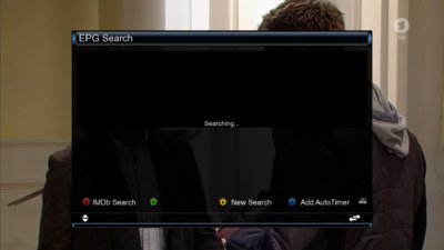

I have test with EPG Yellow button "new Search"

Actually, I don't get what is your problem, exactly, unless you are referring to the different way of working of the new virtual keyboard.
For instance, something I frankly find worse than before, the left/right keys on the remote don't work; so does the < that was very comfortable at deleting to the left, like a Backspace.
Now you are obliged to select the desired action on the virtual keyboard and then you must press OK repeatedly to use it...
Not comfortable like before (indeed very uncomfy) but still possible.
OE-A/Vix images now use a different virtual keyboard.The same rules are for OBH image.
The button function and layout are different
but everything works.Besides, it seems to me that the new keyboard has more symbols than the old one.
But this is what you say, it does not happen to me.

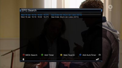

Of course if you start an EPG search you have to wait for the search to complete.
If I not start Search I can close virtual keyboard with exit button.
I can serach EPG and use virtual keyboard.
