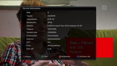

Channel info:
nelone.jpg .
Other channel on the same transponder are Ok.
1 minute and 22MB .ts file attached to test.
Can someone test this with new Blackhole and confirm is it ok or not Ok.

Channel info:
View attachment 11195 .
