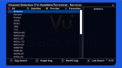

Attached are screenshots of local tv stations in Atlanta, Ga. U.S.A.
