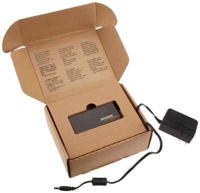

About the external powered hub USB, I don't have any but I can buy one, there is a special requeriment for VU+ UNO or any could work? For example this from Amazon Basics:
https://www.amazon.com/AmazonBasics-Port-2-5A-power-adapter/dp/B00DQFGH80/ref=sr_1_1?ie=UTF8&qid=1471512452&sr=8-1&keywords=amazon+basics+usb+hub+powered

About hub USB, anyone is OK BUT THE HUB MUST HAVE EXTERNAL POWER SUPPLY.
The one you have linked HAS NOT EXTERNAL POWER SUPPLY, so it's not ok.
Sorry but I think that it has, look at this picture:
