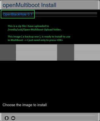

For the named "guest " pack the entire created folder <vuplus> using a zip tool ...
1) If you copy this entire <vuplus> folder and subfolder to the root of an USB pen drive ... you can flash your STB ...
2) For the named "guest " pack the entire created folder <vuplus> using a zip tool ... like: winzip, 7zip, winrar, peazip, etc and zip it to file name that identifies your image ...
for example: Blackhole_217, Blackhole_216, OpenBlackHole_01, OpenBlackhole_Jul2015 ...
This will give you a file named Blackhole_217.zip; Blackhole_216.zip
You can use this zip files to install in Multiboot using Open Multiboot plugin.
see the screenshot:
Best regards
