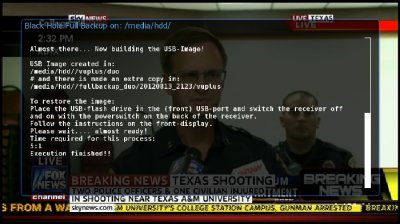

If you are making a full backup for the first time, pay attention to the instructions given on screen when the backup is completed; see picture. Is the backup saved to the harddrive you should find it here: media/hdd/fullbackup/vuplus using a FTP client. In FileZilla I could not copy 'vuplus' to the PC, it had to be 'dragged and dropped'
I see now it can also be transferred directly to a USB stick. And if you make additional backups they will be saved/stored according to date.
Once you've done this the restore procedure is the same as a new installation. ...
