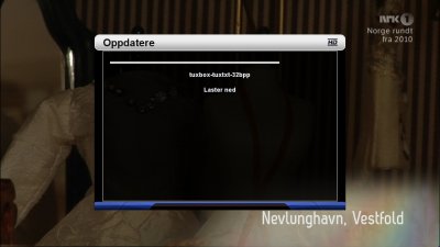

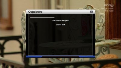

Yesterday i did a online image update scan on my solo2, there was some small updates.
They installed OK , but after restart the online update still says it is 2 updates available when i re scan for new
updates.
What is wrong?

I made a online update for DUO2. 39 packages was installed.
Info says version BH2.1.0.1 Build 2014 -25-8
Reboot after installation.
The teletext is all gone.
you can try:
opkg remove tuxbox-tuxtxt-32bpp
opkg remove tuxbox-libtuxtxt
opkg install libtuxtxt
opkg install tuxtxt-enigma2
If this don't fix you have to flash 2.1.0.1
