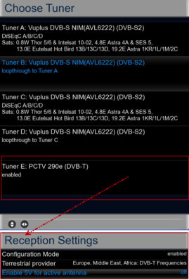

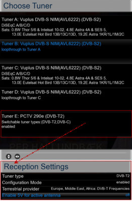

Unfortunately there is still issues when having (one and/or two) "Hauppauge pctv nanostick t2 290e usb-tuner"
(Only one usb-tuner is present in the tuner setup)
Duo2 configuration:
Tuner A: Vuplus DVB-S NIM(AVL6222) (DVB-S2) - slot A
Tuner B: Vuplus DVB-S NIM(AVL6222) (DVB-S2) - slot A
Tuner C: Vuplus DVB-S NIM(AVL6222) (DVB-S2) - slot B
Tuner D: Vuplus DVB-S NIM(AVL6222) (DVB-S2) - slot B
Tuner E: PCTV 290e - USB port
Tuner F: PCTV 290e - USB port (Not present in the tuner setup)
Usb Tuners are located in separate USB ports on the back (usb power y cable is wired, between the two USB ports on the back)
1. Startup issue (flow):
1A. Reboot box
1aa. dvb_debug_duo2_bh301_20151128_reboot.txt
1B. Choosing a DVB-T channel
1C. BOX CRASHING dvb_debug_duo2_bh301_20151128_enigma2_crash_1448703597.log
1D. Restarting Gui
1dd. dvb_debug_duo2_bh301_20151128_reboot_restartGui.txt
1E. Choosing a DVB-T channel
1ee. OK
2. Issue (two usb tuners):
The normal "Tuner handling system" selection/priority/reservation/dataflow
, do normally work like a charm (Slot tuners)
But when having 2 x "Hauppauge pctv nanostick t2 290e usb-tuner"
Somehow it seems, that some parts of the "Tuner handling system", knows that there is "2 x Hauppauge tuners", where other parts of the "Tuner handling system", do not
Looking forward to a solution
Best regards
dvb_debug_duo2_bh301_20151128_TunerSetup_reboot.jpg dvb_debug_duo2_bh301_20151128_TunerSetup_reboot_restartGui.jpg
