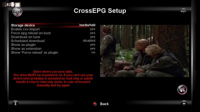

How 2Setup CrossEpg
1) Setup> CrossEpg!
Pic 1
from there Press Configure
2) Choose a storage device, use the my setup as guideline,,,U can adjust CrossEpg function 2 your liking (<> @RC)!
Pic 2
When done, press red (back)!

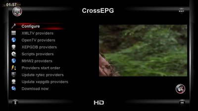

3) (Pic 1) will show up again , from there press on Update xepgdb providers !

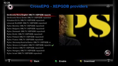

4) after the process is finished, press on XEPGDB providers, the next (Pic 3) will show up
Pic 3
4) Select green button to Enable the EPG providers U need, a green check mark will show next to the provider chosen!
5) When done press yellow button for Download or do the next step before that (extra epg info)!

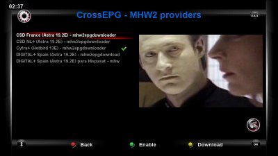

6) Press red(back)...then press on MHW2 providers, the next (Pic 4) will show up
Pic 4
press green for selection.
7) Press red (back)...from (Pic 1) press Download now!

How 2Setup CrossEpg
1) Setup> CrossEpg!
Pic 1
Pic 2
Pic 3
Pic 4

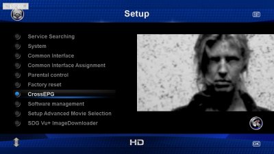

Hi, I am obviously missing something fundamentally to make this work. Do I need to download the crossepg plugin from somewhere? I cannot see it in the plugins, I also don't appear to have the same screen that you are showing me above, all I managed to do was give myself a migraine. Can I have even "Noddier" instructions. Thank you from bewildered
Look up Crossepg under setup/system!
