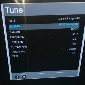

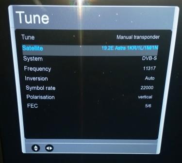

In the postioner tune menu it only lets me try to tune only two sats.
But in the tuner main menu i have saved four sat using non usals

Tuner b is set to second cable of motorised dish witch is going straight lnb.tune 1.jpg tune 2.jpg
Here are couple of pics as i said i have four sats in main config but it will only let ahve two in postioner tune

I Go in to tuner a config save a sat and then go into postioner tune menu to move dish.
But after saving four sats in tuner A still only show two in postioner tune

There isn't a Position Tune menu, on Black Hole, but a position Setup, and you can only move to satellites stored correctly in the Tuner Configuration menu.
Can you please post an image of your Tuner A configuration, for all the satellites you have stored.
