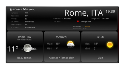

Hi,
I fixed the plugin, using a de-compiler (Easy Python Decompiler v1.2) and obtained a file
plugin.pyo_dis and I then edit with Python 2.7.9 the following lines and save with .py extension for that everything works ...
url = 'http://weather.service.msn.com/data.aspx?src=vista&weadegreetype=C&culture=it-IT&wealocations=wc:ITXX0067'
url = 'http://weather.service.msn.com/find.aspx?src=vista&outputview=search&weasearchstr=%s&culture=%s' % (quote(self.city), self.lang)
url = 'http://weather.service.msn.com/data.aspx?src=vista&weadegreetype=C&culture=%s&wealocations=%s\n' % (self.lang, pin)
You'll find the files here
