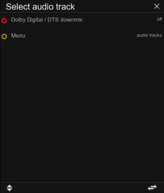

The image update failed to correct the audio output error on the channel "Stingray Festival 4K".
Satelite: Eutelsat 36B & Express AMU1 at 36.0°E
Frequency: 11862 R, DVB-S2, 8PSK, SR 27500, FEC 3/4.
I am getting REALLY tired of repeating this.
Complain to Vu+ not us.
It also does not work in the official Vu+ images.
Picture quality in latest driver is very saturated even if u change colorspace and colordepth setting still saturated unlike 3.0.5A
Complain about the VU + do not! In the OpenPLi 6.2 image, there is a sound on the "Stingray Festival 4K" channel.
