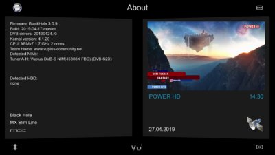

Good afternoon. How to check when my resiver is made and given on it for multistream. Thank you
SN: I0 151800123
FBC-S2
Yes tuner is 45308X FBC (DVB-S2X)
What a problem you have ?
If you have this tuner and Satlist for Multistream
with Black Hole 3.0.9 you can receive Multistream channels.
Look on the forum info about MIS and you have SatList for testing.
Most of Satlists on the WWnet with the stream in the Satlist name support Multistream.
Or you make your own manual scan with all the necessary parameters for Multistream.
Everything was established without any problems.
