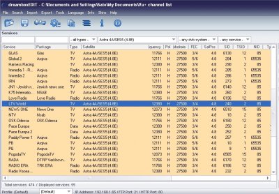

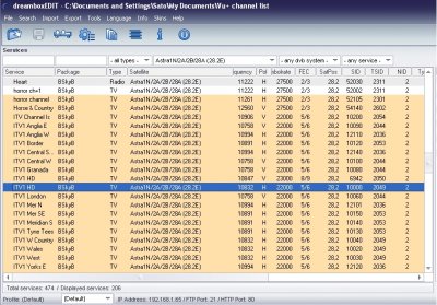

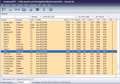

Dreambox Edit (all satellite names are correct):

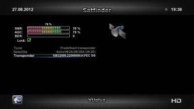

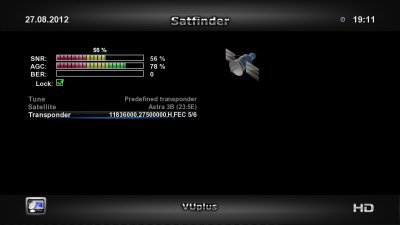

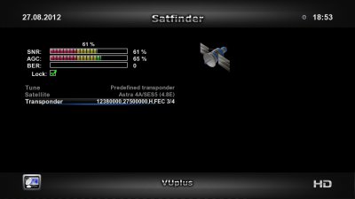

Satfinder (all satellite names are showed correct):

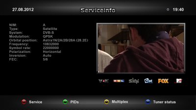

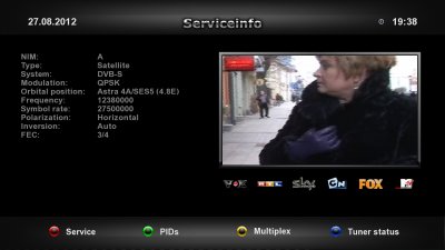

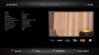

Service Info (all satellite names are showed correctly):

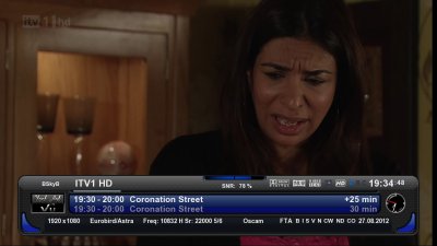

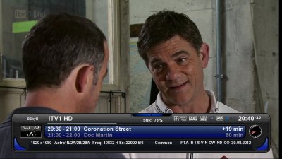

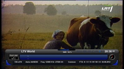

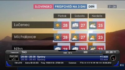

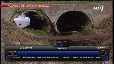

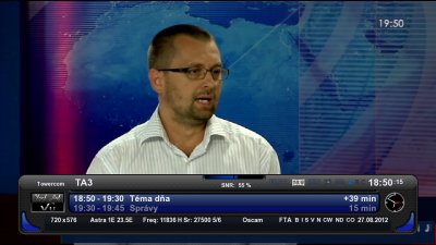

Info bar (old name/incorrect satellite is showed) :
I have also used different skins not the only one I usually use (Rihanna5default_BH1.6x_VU_f3), but nothing changed. I used BH 1.7.3 and 1.7.5 with the same results... Tested on Vu+ Uno and Vu+ Duo, so there must be something wrong in the image.

Hi Shiro,
you have done a great job again. Everything works like a charm! I would like to say my big thank you as I really appreciate your quick reply and the fix you uploaded.:thanks:
Regards
Sato
