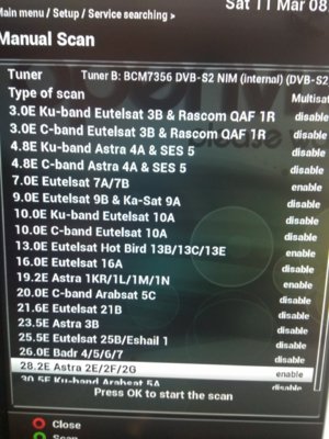

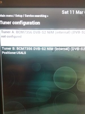

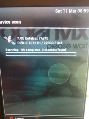

I bought the Solo2 receiver yesterday from World of Satellite. It has got the latest OpenVix image. The satellite cable is connected to LNB in 2, as per instructions of the reciever for when you only have one cable connected. I left the dish pointing at ASTRA 1 19.2 E when I disconnected the Spiderbox. I have set up turner B in Simple, positioner, and these figures: 005.XXX west 051.XXX North. Turner A is in loopthrough B. In the Manual search I have enable the Satellites that I want to search and right now is doing Service scan: Its past EUTELSAT 7E without finding anything . It is in hotbird and its only found 10 channels after 25% done.
What am I doing wrong?
Your Latitude, and Longitude, roughly place you in the South West UK, is this correct?
Check with dishpointer.com, just type in your postcode and check your general latitude, and longitude.
On dishpointer that comes up with Latitude 51.5N Longitude0.543W, which could explain your problem, change your logitude from 5.xx W to 0.5xx W and see what that does.
