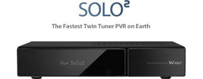

There is no such VU+ model, as the VU+ Solo2 SE, official versions include:
VU+ Solo 2
VU+ Solo SE
VU+ Solo SE v2
Clone models include the VU+ Solo2 SE.
If you are using a clone model you will not get any help, on this forum.
If using a VU+ Solo 2, you need to remove the files/folders, on your hard drive, that are causing the problem.
I think it's the VU+ Solo SE v2 then as there is a little 2 after Solo...so that must mean version 2
How would you go about tracking down the offending files?
That would make it a VU+ Solo2.
Each Blackhole version only works with the correct VU+ model.
Using Filezilla, or other program, try connecting from your PC and delete any folder labelled Kodi, on your hard drive.
Look in the media folder, hdd sub folder.
