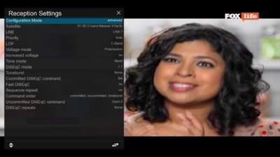

C band lnb tuner configuration
I do not believe that Lnb uses DISEqC.
It switches From Vertical to Horizontal depending on LNB voltage.
So config Is probably simple
Voltage mode Polarisation, The rest is all No.
Of course I'm not sure because I do not have such an LNB
That's just the assumption.

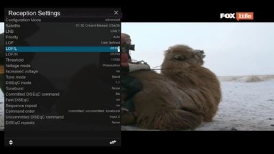

I connected this lnb to 8×1 diseqc switch then does above is correct

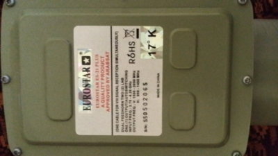

The C band lnb shown in the picture is a band stacked lnb. It does not use voltage to switch between horizontal and vertical transponders. You will most likely need to use two l.o. frequencies (5150/5750 MHz).
Google search "band stacked c band" or band stacked lnb for more information.

DiSEqC switch S8/1PCP-W2
How to assign LOF in advance configuration
You cannot use 11700 for the threshold because 11700 is ku band.

Could I use threshold value of 1500 MHz. Since vertical if is starts from 1550 MHz
I think the threshold will be where the 22Kh tone comes on to switch l.o. frequencies. So a 1500 threshold will not help. It will be best to use another c band lnb besides this one, or create two satellite entries for each satellite and have one for the 5150 l.o. and another for the 5750 l.o.
