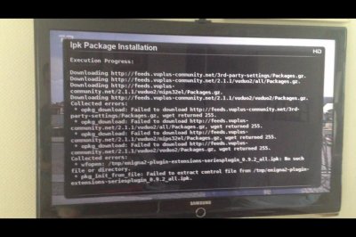

This do not work either, see result in picture. And the AutoTimer plugin is not in the green>yellow addons, and it is this addon i want to install.

Seems you have some problems on your network setup on into your network in general because you cannot download files from Feeds.
Please use Google DNS (8.8.8.8 and 8.8.4.4) instead of your ISP or your router DNS settings and report here if the problem persist.

Still the same error with Google DNS. But if I can see the addons i think internet i working fine, I can also use hbbTV with no problems.
Can it be a problem with write access in the flash or something like that???

I think your flash is OK but your box generates an error when uses the "wget" linux utility to retreive packages list from feed server.
