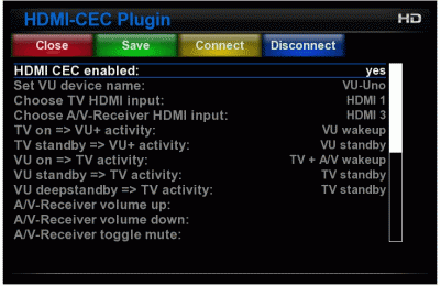

I can not get to work HDMI CEC.
VU+ Uno ---> (HDMI-3) Onkyo AV Receiver ---> (HDMI-1) Panasonic TV
HDMI CEC (Viera Link in Panasonic) works fine between Onkyo & Panasonic (On/Off, Volume, сhanging channels).
My settings:
HDMI CEC enabled: yes
Set VU device name: VU-Uno
TV HDMI Input: HDMI 1
A/V-Receiver HDMI input: HDMI 2
TV on => VU+ activity: VU wakeup
TV standby => VU+ activity: VU standby
VU on => TV activity: TV + A/V wakeup
VU standby => TV activity: TV standby
VU deepstandby => TV activity: TV standby
Please help. How can I debug this issue ?

Uhm...
You have setup the box with AV-Receiver HDMI Input as HDMI2 but your box is connected to HDMI3.
Ok on the image is setup correctly.
