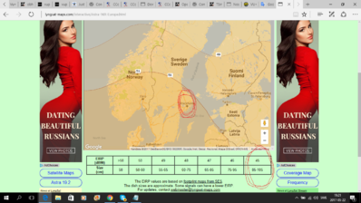

If you check lyngsat, you will find that transponders can be on a different satellite beam, requiring a larger dish, or more accurate alignment, to receive them, especially the HD channels.
Try manually scanning in 11686 V DVB-S 22000.
You can check the channel beams by clicking on the beam link, for 19.2E, they have the Europe beam, Europe wide beam, Pan Europe beam, Europe KU beam, and maybe others:

Given that you are using a 1.2M dish you should have no problems, with those signals, as they are all on the Europe beam:
http://www.lyngsat-maps.com/footprints/Astra-1KR-Europe.html
