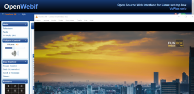

Hi
today I test a Channel 4k on hotbird
on the screen it will switch to radio mode sound without image (blackhole 2,14
but once on the Channel in web interface is visible on VLC
so I wonder if going to be possible to integrate only a codex for enigma2 image to view as was the case with Enigma1 Hd DVBS
what do you think

This is interesting, but haven´t you got freezing?

The H265 codec cannot be implemented into current boxes.
The reason you can see it via VLC is simple: the PC decode the stream and the box don't do nothing.
