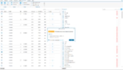

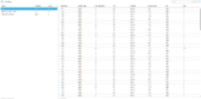

I did many manual scan, blind scan etc, nothing, then find a other backup, with restore most of the channels (but still a few one missing)
When I sync with E-Channelizer then I have more missing services and when unknown transponder with (I think) some english channel from 28.2

Then stop using E-Channelizer.
Instead, once your backup is working, do manual scans of any missing transponders.
