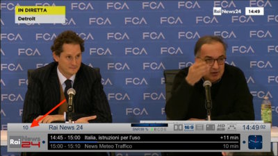

I have a VU+ Ultimo with latest BH image 3.0.1.
I had two problem:
1) The time was incorrect, 30-40 min behind.
2) I can't enable the channel number on OSD infobar, neither with default skin or HQ5 skin
I could find a solution for 1), that is insert a cron command to syncronize the time, but
I have no idea on how to solve 2).
Can anyone help, please?
The channel number in infobar is enabled by default in Lite Infobar.
To enable it:
Blue Channel > Extra Settings > Osd Settings > Disable Lite infobar on Zap: No
To enable it:
