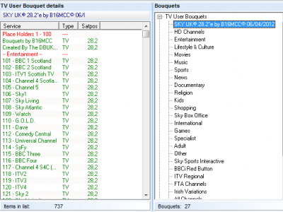

I added 100 fake channels in un-named bouquet.
Then from channel 101 to 999 they follow the correct numbers, once you allow duplicate channels to be entered in dbedit.

In dbedit, I have favourie bouquets set.
the first has a blank name and inside here, I just used the epg channel listed as - 100 times.
Then the 2nd bouqet is sky uk with channels 101 - 999 in order.
Hard to explain but if you open dbedit it should make sense
EDIT: See the picture, hopefully it will help.
As you can see, bouquet name is blank, and I put 100 channels in there, the first few are bbci as it was handy for f1 last year.
Then 101 on in the sky bouqet

dont think am doing something right - Ive created a blank bouquet but where u said you put epg channel in 100 how did you do that
The way it is just now is
under tv user bouquets
placeholder 1-100
bouquets by *******
create by *******
****Entertainment*****
Then under Bouquets just the usual listings.
Are you saying create a blank bouquet under bouquets section and add the epg channel 100 times?

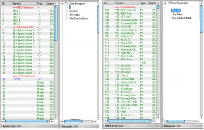

go into the sky bouquet (assuming your using silverfox settings).
Pick the channel with name -
highlight it and press ctrl c on your keyboard.
Then go into blank bouqet and press ctrl v (100 times) :D
You need the 100 channels (they can be anything, I just used blank as an example) before your sky bouquet.
this is how mines looks
sorry for the questions.....
when i created a blank bouquet it only lets me put one channel name in it not duplicates
as you can see mines a different
go into dbedit, and in the options tick allow duplicate entries.
Then make a bouquet above the highlighted one.
EDIT: You will need to download the bouquet again from where you got it from, as all duplicates have been removed already
ok thats just weird lol - followed instructions above and it pushed all channels forward 100 places so I deleted them but kept the blank bouquet and its put the channels in order lol
