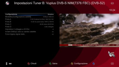

You keep giving us generic and confuse information.
You MUST (not should) give us:
1) the screen grab of your tuner setting, something like the attached picture.
2) the EXACT description of your system, with the specific terms.
No info (or few info) means no possible help.
