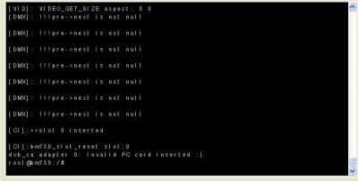

You can try to insert your PCMCIA adapter and do a dmesg command and post the output text, but it's very difficult, as alez wrote, to make it works.
