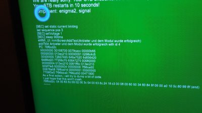

CI module green screen
Just applied the two folders. No more restarts but neither CAM channels are clearing.

here is the zip file for you. just make sure copy them /lib/firmware/ and /lib/modules/ and reboot and should all be good

I do understand but is fixing problem and hope bh team will do something about this problem which has become annoying since 2.1.6 update. Thank you
Problems with CI modules can only solved by Vu+. I understand the frustration but remember that replace Vu+ drivers from one image to another is only a workaround and can cause unexpected problems.
If you have reportd the bug to Vu+ with all HW infos avaiable, I'm pretty sure Vu+ try to solve the problem ASAP.
