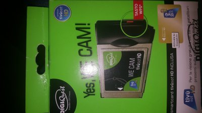

Thanks and Merry Christmas. I tried today but didn't work. Black screen. It's a Digiquest Cam and tivusat hd card purchased on Amazon. Running a Black Hole image on Vuplus solose. It recognises the cam and the card but just doesn't unscramble the channels. I activated the card and got the confirmation email from Tivusat. I've set the default cam to CI using the blue button and even added RAI to the list of providers for the CAM using the CI menu under Setup but no luck. Will have another playaround but would appreciate any pointers on where I might be obviously going wrong.

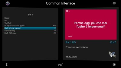

Remember to set the option
High bitrate support to YES
