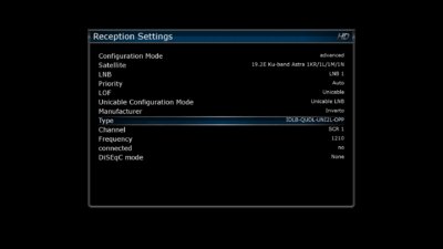

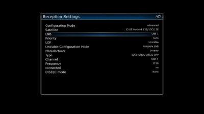

Both LNB´S have the same specs.
1 universal output
1 SCR
You can use the same brand for both ... for example INVERTO.
Look at the SC1 ...
Requesites:
One cable for each input ( tuner )
Mode (advanced ) ... LNB1 ... Hotbird
Mode (advanced ) ... LNB1 ... Astra
or vice-versa.
Example for input 1 ...
Please note that only will change the ( LNB1 to LNB1 ).
A,B,C,D tuner inputs Astra
E,F,G,H tuner inputs Hotbird or vice-versa.
With BlackHole, you just need to configure A ... and E ... for each input.
View attachment 43954 View attachment 43955
Note: You can´t use a splitter to join the cables from LNB1 and LNB2 ( Inverto and Emmesse ), and your antenna and LNB´s must be correctly aligned!
