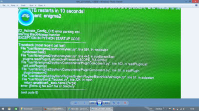

Screenshot (13).png Hi, since I updated my image to latest 2.1.6 I keep getting the following green screen error log every time I try to restart enigma2 and it also seems to coincide with the installed HDD suddenly not being recognized or not initialised!
I'm not sure how to get a proper text of the log, so here's a screen capture. I really hope someone can help as its getting really frustrating!!!
Thank you.

You crash log, it well on your hdd root directory!
post the log here please!

It looks like you have installed a plugin (or a backup) that is not compatible.
The crash does not look like it is an image problem.
EDIT: Do you have a CI module installed ?

I am sorry but i have to tell that i know another friend that have these kind of issues with constant crashes depending by socket fails.
And in his case there is the suspect of an hardware issue. I suggest out of our interest to try to use OpenPli image or other that doesn't use the socket like bh to bypass the problem.

Hi, Just to update my situation.... I installed the OpenPli image a week or so ago and have been testing my box during that period - result is perfect performance, no crashing and really fast, responsive UI. Thank you so much for the suggestion as its solved all the problems - hard drive is also now working reliably with no issues over loss of data. As much as I miss BH, I'm very content with this solution.
