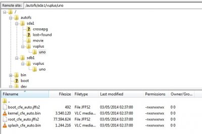

Hi,
today i've tried again but without success again.
I've tried also to format the USB Memory Stick directly
from the VU+Uno itself and then put the vuplus image through FileZilla but the result were negative.. :-(
Here you can see that both the USB Disk are perfectly visible by the Decoder..when the decoder is on..
but when is booting..none of the two USB seem to be "visible"..
I try too to re-download the image file..but the result were the same.

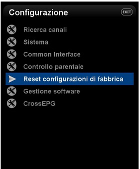

@a911:
Just a question.. when you say:
"If not working ,try Factory rest of the STB...and install new BH image."
1) You mean this option...?
2) I do not try yet this option because if the decoder do not "see" the USB Memory Stick, and i do the Factory Reset..
i think i'll have a decoder with an original image always with the impossibility to upgrade it..
Wait for you reply..
Thank you for the time you dedicate in trying to helping me.

@a911
I have no clear idea on what happen when i launch the reset.
What is the result of launching "Factory reset"...?
Is it installing an image saved in an internal EPROM to the Flash Memory..?
If it does this and after this operation i could still not "see" the USB Memory stick during the boot process..
i'll have a decoder with an image installed in flash withoiut the possibility to upgrade it..and probably with an image
older than the 2.0.7.1 that is in the flash of my decoder now..
thank you for your help..
m64
