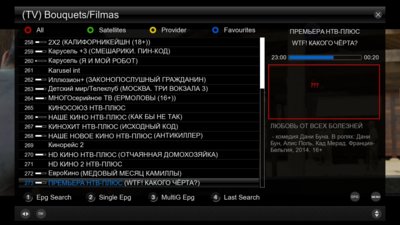

I'm having similar issue with all Blackhole images including latest 3.0.1.F on Vu+ Duo watching Eutelsat 36A/36B.
Just for the testing I've temporary installed Open BlackHole image Vu+ Duo2 v.0.1 and with it current program details were displayed without problem. So, yes, this looks like something Blackhole specific..
Screenshot:
