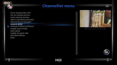

use RC button down, then select your channel > press menu > and you will see option: REMOVE ENTRY

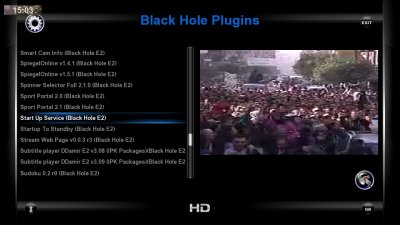

Really man I don't know what to say ... but really this menu is totally different than what appears to me here, first of all my version is BH 1.7.9, I installed the same plugin you recommended "Startup Service", when I press MENU button, a list appears titled "BH Channellist menu" not as shown in your screenshot "Channellist menu", and the options in this menu are only four, another good information that I'm trying to delete a channel in All and Satellites lists, not in Favourites list, so please can you tell me the exact steps after installing the plugins how to get the exact menu as you have ?? thanks in advance
Press menu when U'r at your channel list that U made!
Your (TV) User-Bouquets!
OK, it's obvious that BH doesn't let you remove any channel from the "All" or "Satellites" lists, but the option exists only for "Favourites" lists, I can't imagine how this is a stupid bug, by the way thank you for your patince and support
Well ,,,,,this is in all E2 images and STBs!
And its not a bug in BH image,,,,its the plug-in creator/developer choice !!!!!
