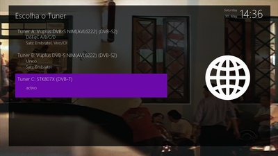

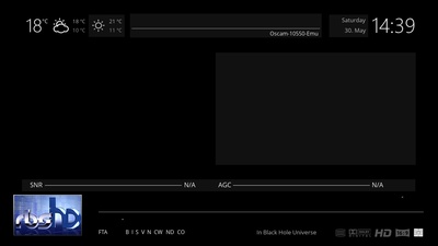

Staff this tunner worked normally in OE1.6 images after migrated to the images OE2.0 could no longer operate the tunner .
In the picture it appears in tunner list as " Tunner C = STK807X (DVB -T) his drive is Dibcom0700 already installed as well. The signal appears only in the AGC SNR no sign of any . The adapter model is PV- D231V ( RN ) -F .
I'm using a BH 2.1.6 and he is listed yes .

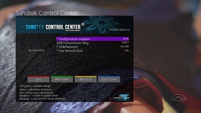

The following photos of tunner settings.
View attachment 20827 View attachment 20828 View attachment 20829
Post debug DVB file (http://www.vuplus-community.net/boa...images-debug-script-per-le-immagini-bh.21512/)
