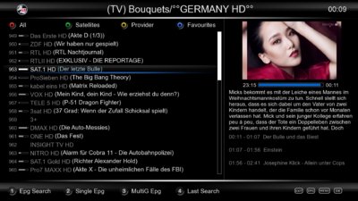

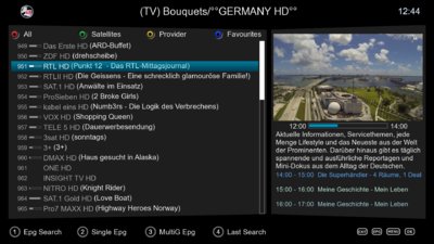

You want something like this ?
YES!!! Exactly :)
Looking forward when available. Thanks a lot
MX Black Sea E (for BH 3.0.7 and up ver)
download from Black Hole image server.
is located on the Black Hole image / skin server.
This is just an additional version for those who want it
like you.
But it will not be applied within the image coding.
If you uninstall skin from Addons Manager
you also delete additional python encoding
Thank you very much for this modification.
I'm testing the skin right now and it's much more useful for me :)
The lines are long enough for 90% of event names so the second line is used quite rarely.
Below I added some questions/suggestions regarding lines formatting. You may (or not) test them in future versions, it's just for consideration.
1. Can the empty lines be used for adding another events?
2. Can for long event names the second line text be left-aligned with the first line text (not reach below the times area) ?
3. Can all lines use the same blue color like the first line ?
Have a nice day and thanks again for your work on this.

1.Adding new lines means that you lose the long event names ,they would be shorter.
This also means a slowdown to navigate through the list.
2.I do not think , the coding of the line is for the whole information,and not separated for time and event.
3.That can but I put a little different colors for better visibility.
1. The idea was to insert new line dynamically, only if there an empty line exists (if event name is short).
2. OK, I understand. The idea was better optical separation of lines and easy read of long event names.
3. Idea here was that event lines create a "next program block" easy to focus on. I though the same/similar color could help.
1.This is not possible with this coding ,and we did not code that.
2.This is not possible.
3.it is again a matter for the user,one like this and the other,other things.
next program block or next program event.
Skin update with "next program block" one color
fix for very long names (cut event text )

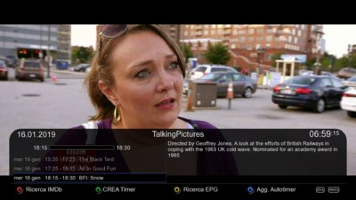

I'd just to tell that in OBH you can browse every events by clicking left or right and then up and down to browse (reading the event description on the right) as in the attached picture.
You can go on until the EPG ends.
