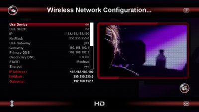

Hi, I have the same mod key D-Link DWA-140 (rev B2), but can not connect to Wifi network and send in the Vu + Duo. Use image Black Hole vers. 2.0.6 rev. B
I tried to configure the decoder 's WLAN interface is in DHCP or static ip, but do not solve the problem, by testing network in the decoder Wirelles the network is disconnected, as if the wifi is connects then disconnects with a bang!
Do you know by any chance which vers. drivers have come to the DWA-140? because I just updated them but I only found the vers. 3.1.2.0 but I think I saw on the net that there is a vers. next ... the 3.1.8.0 for the key in question.
This may be the key drivers or other?
