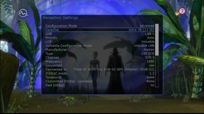

You'll need 1-4 splitter to split SCR signal for tuners (I'm using 4 pcs. of 30 cm long cables from splitter to dec)
(It's possible to use internal loop too from A to B and from C to D, but not using it is simplier to configure)
Next configure tuners as shown on picture, SCR frequency must be different for every tuner config.
Select sat you use, LNB1 is for all 4 tuners.
(This is a picture from motorized USALS SCR dish ;), for you it's the same config, just leave Diseqc Off)
If you want to use internal loop, you have to choose correct Tuner for "connected" (Tuner with cable on input has to be set to "no")
