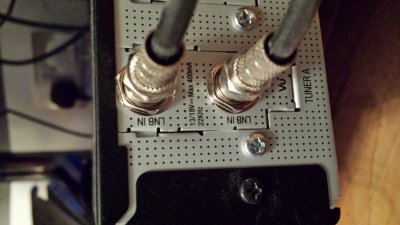

HI you guys; I recently purchased the Duo 2. Mine has two dual tuners (recognised as Tuners A & B and C & D by the software). These dual tuners don't have a loop output but each has TWO inputs. I made it to loop tuner A into B and C into D with the tuner configure utility (this is some sort of internal loop) but never achieved connecting any loop between the two pairs although the sofware shows this. The use of an loopthru cable is impossible with this configuration. The only way to use all the four tuners (eg the two pairs) is to connect a dual feed on inputs A & C. As I don't want to drill a hole for a second cable I would like to know if there is any mean to to fix that. I have only one satellite to aim at with my Canalsat Caraibes subscription here in the West Indies.

The photo shows a DUAL tuner (twice LNB in).
I know this photo shows a single slot dual tuner as that's what I have mate. Like you've said I don't think there's anyway to connect both tuners together the only way is as you have setup A and C to have feeds and internal loops to other tuners... To get the most out of your box I think you need 2 more feeds.

I think hes got 2 input feeds mate ... 1 into each dual tuner... Then internal looped to other 2 tuners
Yes that's my setup. I will try an antenna splitter and feed each dual tuner. Intelsat 903 (34.5 W) has 6 transponders footprinting the Caribbean, all with the same polarization. The problem could the 4 to 7 dB loss introduced by the splitter as we have frequent strong tropical showers affecting the signal.
