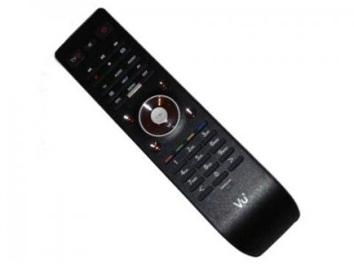

Can anyone tell me does the new duo2 remote will work on other older boxes like Uno, Duo or Solo?
the remote dose work i have a uno and a solo2
and when i got the solo2 i had to set the uno remote
as number 3 to stop the remotes turning both boxes on
at the same time
You can change the code on the Duo2 remote following the instructions below.
6. System Code Change.
You can change the system code of your Vu+ universal RCU according to the Vu+ model that you want to control. The default system code is Mode 2.
Mode 1 : SOLO / DUO
Mode 2 : UNO / DUO2
Mode 3 & 4 : reserved for future models.
Press <<2 + 7>>, <HELP>, <0001 or 0002 or 0003 or 0004>
1. Press 2 and 7 for three seconds until LED is on.
2. Press HELP
3. Press <0001 or 0002 or 0003 or 0004>
But this is to change the new remote control. I would like to change the old control to work with Duo2.
Skickat från min GT-I9300 via Tapatalk
In this case you have to configure the Duo2 to use the relevant older RCU code (using the remote plugin).
Then you should be able to use the old remote model with it.
