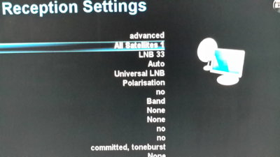

Hello, I'm hoping someone can help with my Duo2 tuner settings (Black Hole of course). I have 1x dual dvb-s2 tuner installed fed by 2 coax from twin output LNB with tuner A cable looped through a positioner which works well. I can scan, tune and allocate satellites via tuner A in advanced setup. I have tuner B set as "Second cable of motorised LNB". With these settings i am able to watch and record 2 channels. Vu literature says you can record up to 16 Channels! I figured with a dual tuner on that basis I should be able to do 8. SO am I being Greedy? Is 2 tuned signals my Limit? Clearly the signals must originate from the same sat I did not check they were from the same transponder
Also should tuner A be set to "advanced, all satellites 1, LNB 33"??? When I have finished scanning individual birds. Why LNB 33???? My head hurts! Help!

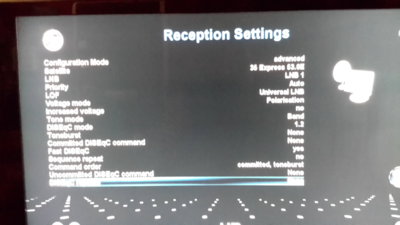

I can't work out why you've got it set to All Satellites, in image 1, yet 53E, in image 2.
Can you please explain, in more detail, how you've set your motor up, using Diseqc 1.2.
Thanks, yes I understand both USALS and DISEQC. I use DISEQC positioning and allocating satellites manualy as USALS is innacurate for me. I merely showed the images to illustrate the options I am talking about, usals/DISEqC has no bearing on it. My motor works fine in DISEqC. I just want to know if the "all satellites, usb33" setting is how to leave the tuner in normal use. I have my second tuner set as "second cable of motorised lnb". I'm sorry if I'm not making myself clear here. ALL the illustrated settings give a picture and both outputs of lnb work. It just seems to me that "All satellites" setting is logical for a motorised setup. Am I maybe being pedantic, does it matter? I just like to thoughorly understand tech settings. Before you ask I don't think I'm OCD!

Thanks Del, I have really no problems with setup but thank you anyway. I was just confused about the "all satellites" setting. Which I've now discovered is a usals option. Anyone looking for a settings guide should try the openvix guide there is a lot of communality and it is excellent! In fact I've migrated to openvix, that is probably heresy on this forum.
