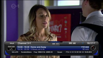

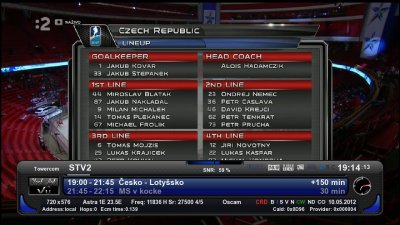

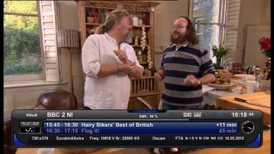

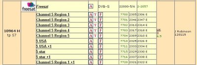

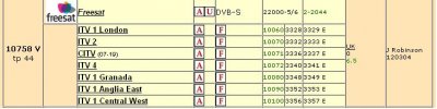

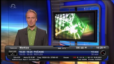

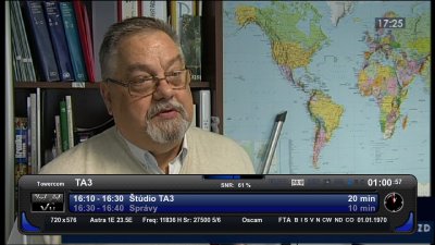

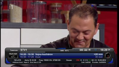

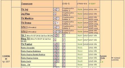

Transponder images showed are taken from Lyngsat.com ® satellite chart and are used for information purposes to point to the problem that continues. FEC on any channel with 5/6 is showed as 4/5 no matter what satellite, provider or frequency the receiver is....
1) 23.5*E Astra 3B & Thor 2 - frequency 11836 H FEC 5/6 - info shows 4/5
2) 28.5*E Eutelsat 28A & Astra 1N/2A/2B - frequency 10758 V FEC 5/6 - info shows 4/5
3)28.5*E Eutelsat 28A & Astra 1N/2A/2B - frequency 10964 H FEC 5/6 - info shows 4/5

It is not only on a few channels.. Check any satellite or frequency where SR 5/6 is used and you will see! It is on every channel that uses that SR. I don`t agree with you that it is a "cosmetic" problem only as this information is very important as I do take screen shots of TV stations. Can you imagine that you upload somewhere some pictures and the info is not correct? Would you be not ashamed for that cr*p? Usually people check Frequency, SR and FEC if they are about to search for a new channel. It is really pity that people on this forum keep solving lots of other problems that are irrelevant and nobody is interested in this. I would be more than happy if people from the BH Team wrote a few words as this "nonsense" information shows on the default skin that appears straight away after a new BH image is loaded. Or nobody out there from the BH Team cares??????????????????? Other image can show the FEC correctly, so why shouldn`t the BH do the same? It is very good image and I like it, but please do something about that SR, will ya? By doing this you`ll show that you do not only care about details as they do matter too, but mostly that you can improve the image to its best! Look is not everything...it is the information that matters really.

It worked well to me. I checked Frequency 11836H 23.5E and now it is showing 5/6 as it should be. Thanks for the quick response.

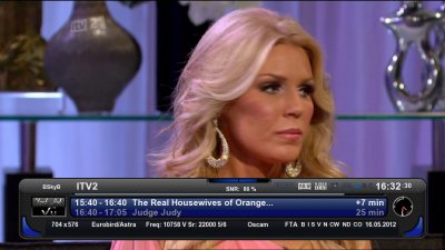

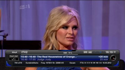

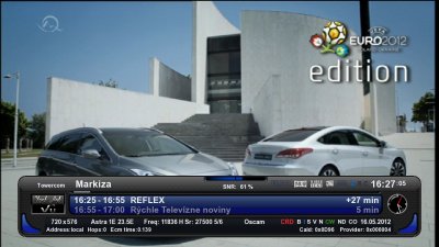

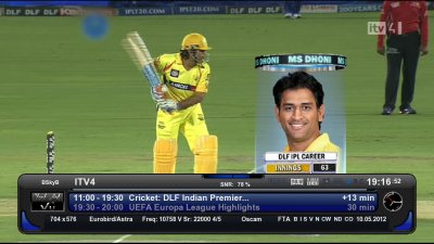

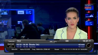

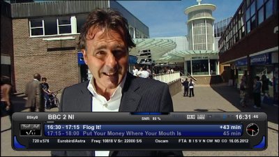

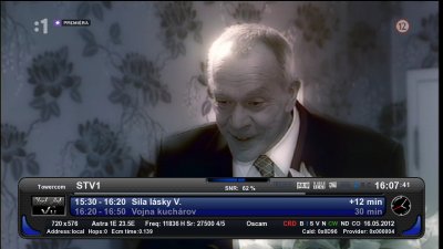

Seeing is believing, so here are some pictures to prove, that your fix really works and you have done a great job!
Pictures before the fix being installed: BBC 2.jpgITV 2.jpgMarkiza.jpgSTV 1.jpgTA 3.jpg
After installation: BBC 2.jpg ITV 2.jpgMarkiza.jpgSTV 1.jpgTA 3.jpg
No prob i have already committed the fix in Bh git for the future releases.
It was only a little and stupid fix of a typo.
