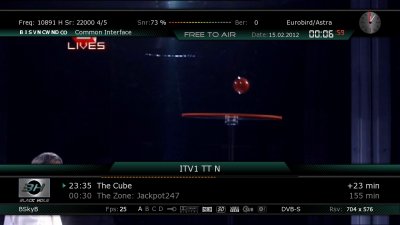

I use very often screenshots from my VU+ Uno at our satellite forum, so I couldn`t miss the problem that is in your Black Hole image and is related to showing wrong FEC. In the additional info bar (2xOK) Black Hole image shows FEC 4/5 instead of 5/6. I`ve tested BH 1.6.6 and up with different skins as I thought the problem may be in the skin I use, but all skins showed the same wrong info.

This is not a problem on 1 frequency or only with VU+ Uno receivers. A friend of mine have checked the same on his VU+ Duo loaded with the BH 1.7.2 and the problem`s the same.....
Here are a few pictures I made for you (BH 1.7.2 and Open AAF release 12.2.2012) to better understand the problem. Correct are from Open AAF image and the wrong ones are from BH 1.7.2. The only skin that really works and shows FEC 5/6 as it should be is an HD Glass skin, other fail to do so
