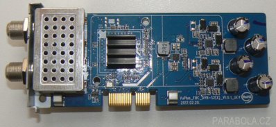

The tuner
FBC DVB-S2X
is designed only for VU + Ultimo 4K, VU + UNO 4K SE and VU + UNO 4K

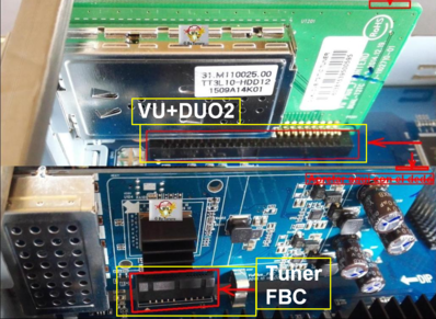

For VU+DUO2 not (12.6.2018), as the partner indicates, they are FBC tuner, another connection socket.
They announced them in Anga2017, but at the moment they are not commercialized.
Those that are sold are the old ones similar to those shown by the partner.
This does not support multistreaming channels currently.
I ask in a store and at the moment nothing, there are no sales plans, this week a friend bought a VU+Ultimo4K and wanted to know what tuner he has.
In the future we hope it is just a driver update.
