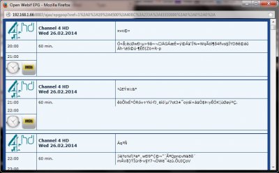

However, using the Blackhole 2.09 image I am finding that the UK Freeview EPG is not populating the correct information.
The EPG populates a lot of random symbols rather than English.
For example, this is what is shown in the EPG for Channel4 HD
Channel 4 HD
Wed 26.02.2014 xvc©»€
20:00 60 min. Ó»å›;è¿Øw›Ð:µ>9â~¬ÄG“ÁæÈ=ý©Á¥';=WqÁöî¶õ4ñv˜s§ÍYDðê©áûÁh·\ë5©ú·¶‹ÊšßŠ|Zö÷R-–p
21:00
This listing relates to a programme called Restoration Man
Is this something that could be fixed in a future version of the Blackhole image ?
Same issue here with epg ,works fine on vix image though.
Was using latest blackhole ,any fix in the near future ?

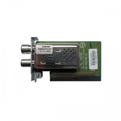

Hi guys! I have an Vu+Solo2, as far as i understood from now, solo2 don't support internal dvb-T2 tuner ?
i want to change one sat tuner from my box, i don't need/use it..
The usb dvb-T2 tuners are expensive for some channels only..
You cannot change Solo2 tuners because they are soldered on board.

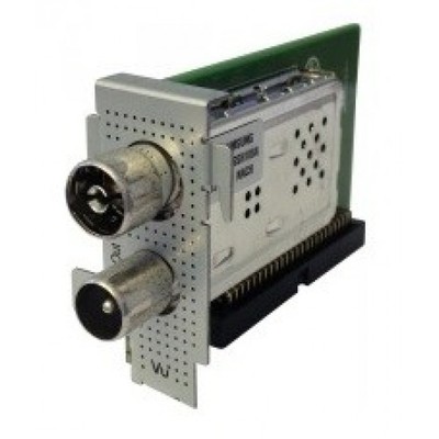

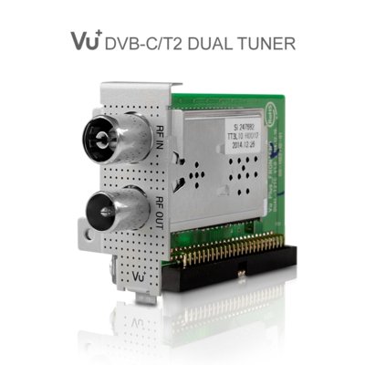

I can see in the internet shops that vu+ dual (hybrid) dvb-c/t/t2 tuner is on sale, but can't find any official proof. Please confirm, specs and fotos would be much appreciated.
Yes it exists and has been on sale for a while now.
It looks the same as the single tuner, there is nothing much different to look at.
The model number is TT3L10
