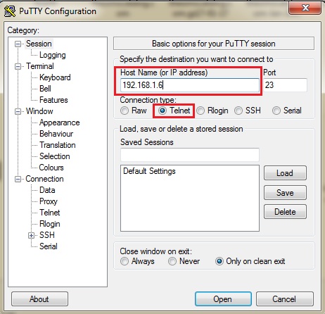

How to connect to your box?
I am going to explain how to use PuTTy for anyone who has never done that before. Any PRO reader, please jump to the next section. Newbies stay with me. Let’s begin! The easiest way to connect to your box is to download telnet client, I am using PuTTy. This is very simple and easy to use telnet client and you can download it from here, Once you downloaded and installed PuTTy on your pc or laptop open it up and you should see window(you might be asked to run it as admin first on some machines) like the one below.
https://i.postimg.cc/fbQwrKyD/putty.jpg
Just put your box IP on the Host Name field and set Connection Type to Telnet and you’re done. Click Open and you should see PuTTy telnet window like the one below. https://i.postimg.cc/2SKHkchN/telnet-window-enigma2-opt.jpg
To connect to your box you just need to enter your login which in most cases is root and by default there is no password. If you want to setup one you can do that, just scroll down the page and use one of the commands below. This is how your telnet window should look after you’ve logged in.
