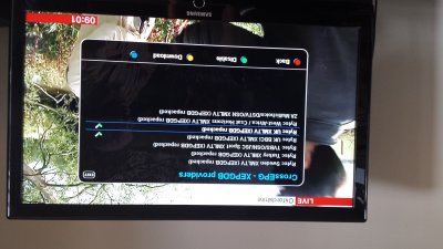

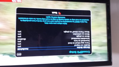

Hi mate first configure cross EPG. Select save to HDD. And yes to all other options. Update all providers. Disable all other EPG and try just xepgdb rytec UK bbci xmltv andrytec UK xmltv. Check provider start order mine has bbci one at top. Go back and select download now.
Had a quick chance to try the suggestions out. Fist off I deleted the crosssepg on my media folder and stated from scratch. I set up the xepgdb rytec UK bbci xmltv and rytec UK xmltv and down loaded them. The sat channels populate fine as normal, but still no EPG data on the freeview dvb-t. Maybe I am doing some things wrong here. If you guys have the time, the help and suggestions are greatly appreciated. Thanks.

Setup CrossEPG to XEPGDP --> Rytec UK BBCi XMLTV
You must tune in your receiver to a Terrestrial program eg. BBC1 for the epg to populate
Cheers. So I can disable black hole eit settings, and just use cross epg with the download on tune option, and go to bbc 1 on my terrstrial channel list and it should populate. Thanks I will try this later.
